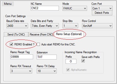

Open easyDnc setup and select the 'Remo' tab and then check the box to enable Remo.
Remo Reqst Tag
When Remo is enabled it's always 'listening' for data from the CNC. Such data would usually be an incoming file which will be saved to the CNC's default program folder. But when the CNC sends the Runner you need easyDnc to recognise it and read the instructions it contains.
The Reqst Tag tells easyDnc how to recognise the runner. This can be the program name. In the picture to the right you'll see we've entered O9999 as the Reqst Tag. We're telling easyDnc that we're going to use program O9999 as the runner. A typical Runner file looks like this:-

Incoming Name Recognition
Prefix. Before a file from the CNC is saved to disk Remo scans the file to get the file name.The 'Prefix' tells Remo what character or symbol to look for. In many types of CNC this will usually be the letter 'O' as in our image above. For example a program received from the CNC containing the text O1234 would be recognised and saved to disk as O1234.TXT
In some cases though you may wish to save to disk using other text. For example if you entered an opening brace ( into the prefix box and a file from the CNC contained the text O1234 (MYNAME) then Remo would ignore the real program name and save the file as MYNAME.TXT instead
Save with Prefix tells remo to include/exclude the prefix character in the filename.
Extension is appended to the filename when saved. O1234.TXT
The Extension
is also appended to file requests. So, if the CNC/Runner called for file 5555 then Remo will look in the default folder for a file called 5555.TXT
