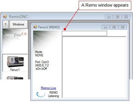

A Remo process can be started to serve one CNC machine. You can start a number of Remo server processes so that you can serve a number CNC machines at the same time.

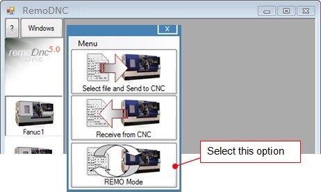

To start Remo click the relevant CNC icon and select 'Remo Mode' from the menu. (If you don't see this option then you didn't enable it in Setup)
A Remo window appears and you see the status in the lower left corner of the Remo window. "Remo Listening". You can leave this window as it is if you want to observe it. Or you can size, position or even minimize it so you can do other things while Remo is running in the background. While Remo is listening you can do everything else at the CNC console.
