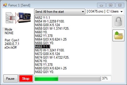

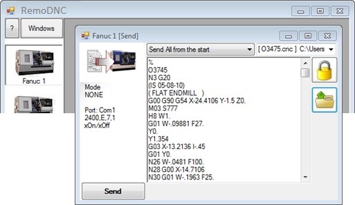

A DNC window appears containing the selected program text.
When you hit the [Send] button the data starts feeding into the CNC and you can see the progress as data scrolls up through the buffer window and the progress bar moves left to right.
Also notice that the Send button has been replaced by other buttons allowing you to Stop or temporarily pause the transmission.
