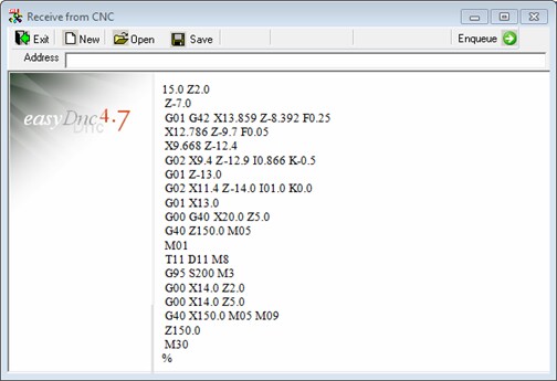

As the CNC sends the data you should see it appear on easyDnc desktop.
The receive window also functions as an editor where you can edit the data before saving if required. Alternatively you can click the ‘Enqueue’ button to load the edited data into the easyDnc transmit buffer and send it right back to the CNC.
CNC terminal code appearing dynamically within the easyDnc editor window
