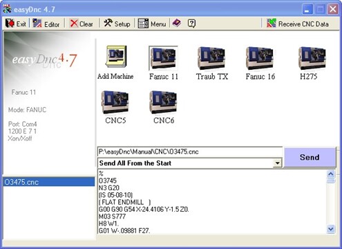

The selected file appears in the easyDnc send buffer – that’s the text area in the lower half of the easyDnc window.
In our example the text area is quite small but you can drag the centre bar up and down to increase the size of the text area.

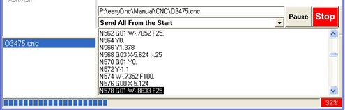

Prepare the CNC console for input and click easyDnc's [Send] button. As the data starts feeding into the CNC the data scrolls up through the buffer window and the blue progress bar moves left to right.
Notice that the Send button has been replaced by other buttons you can use to Pause or Stop the transmission.
Just to the left of those buttons you see the current mode "Send All From the Start". This is the default mode where the whole file will be sent to the CNC.
We'll discuss this option, and others, in more detail on the following page.
